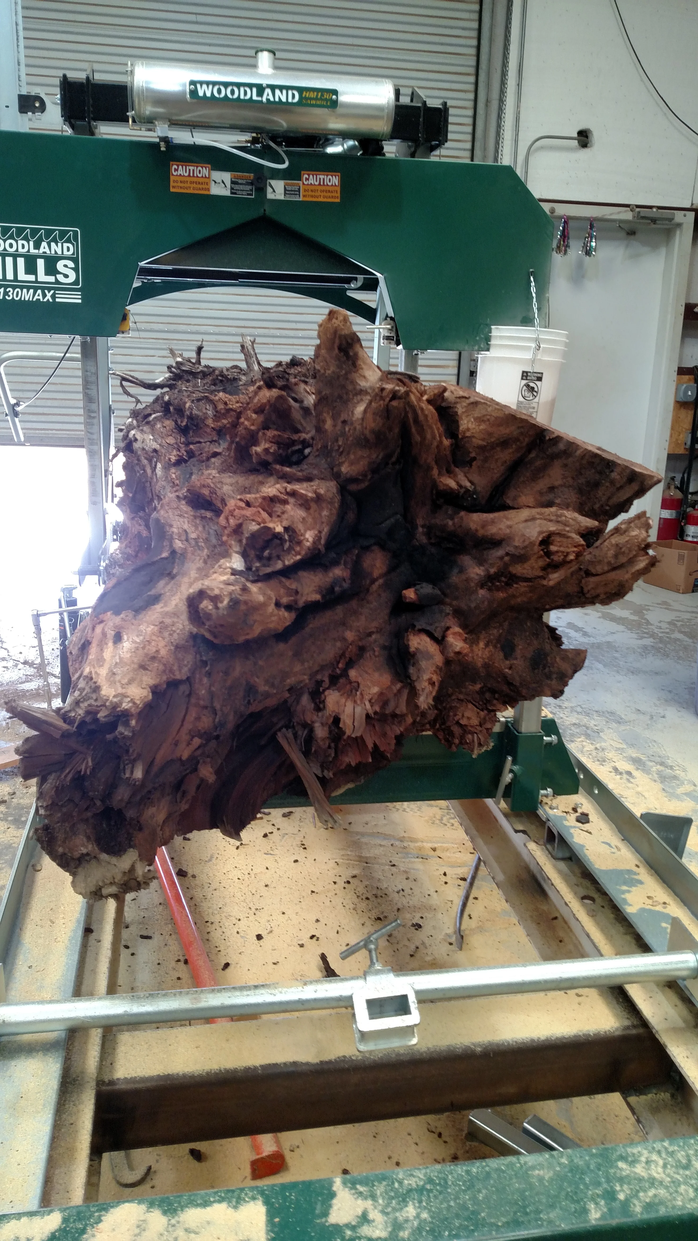

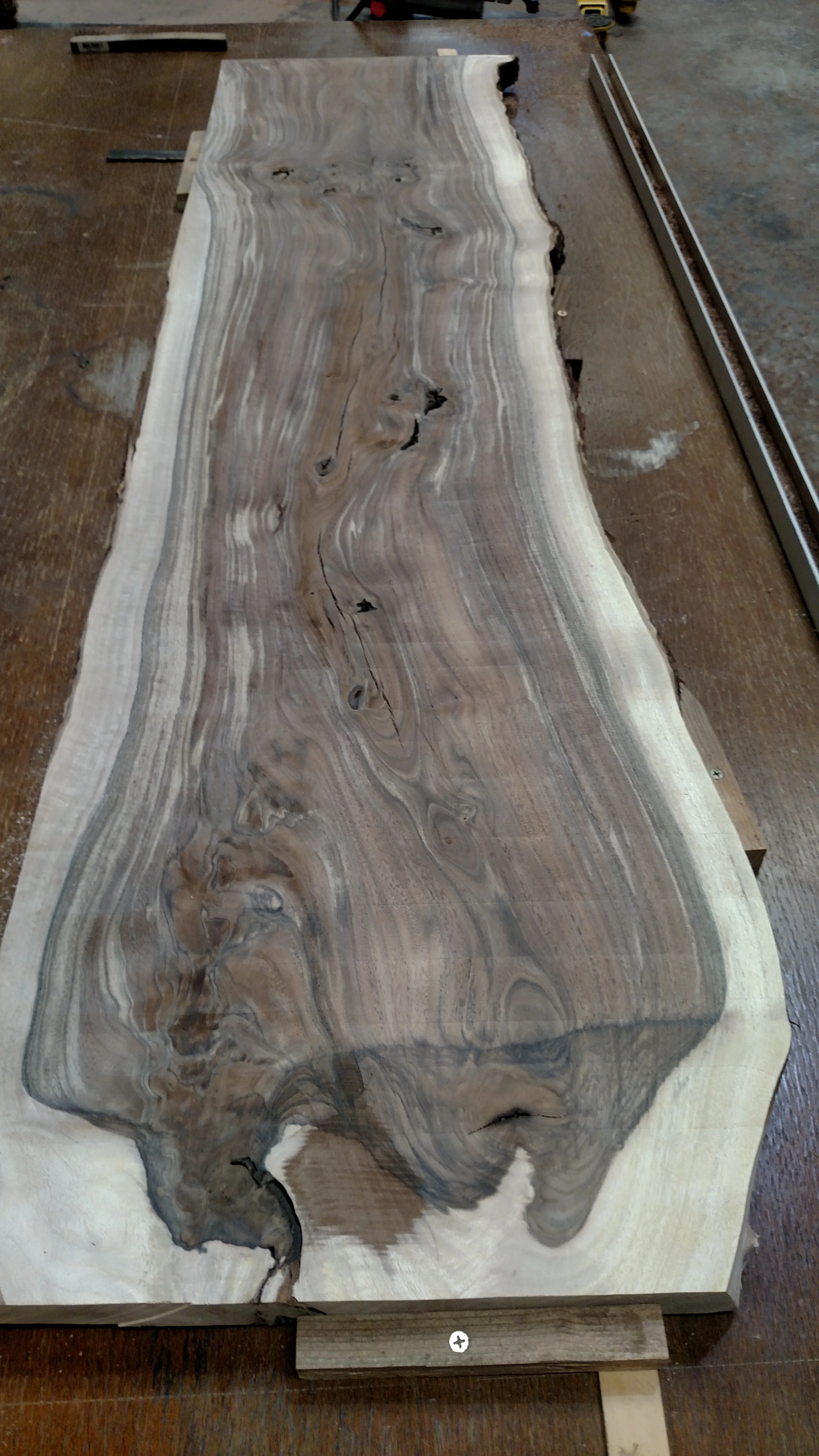

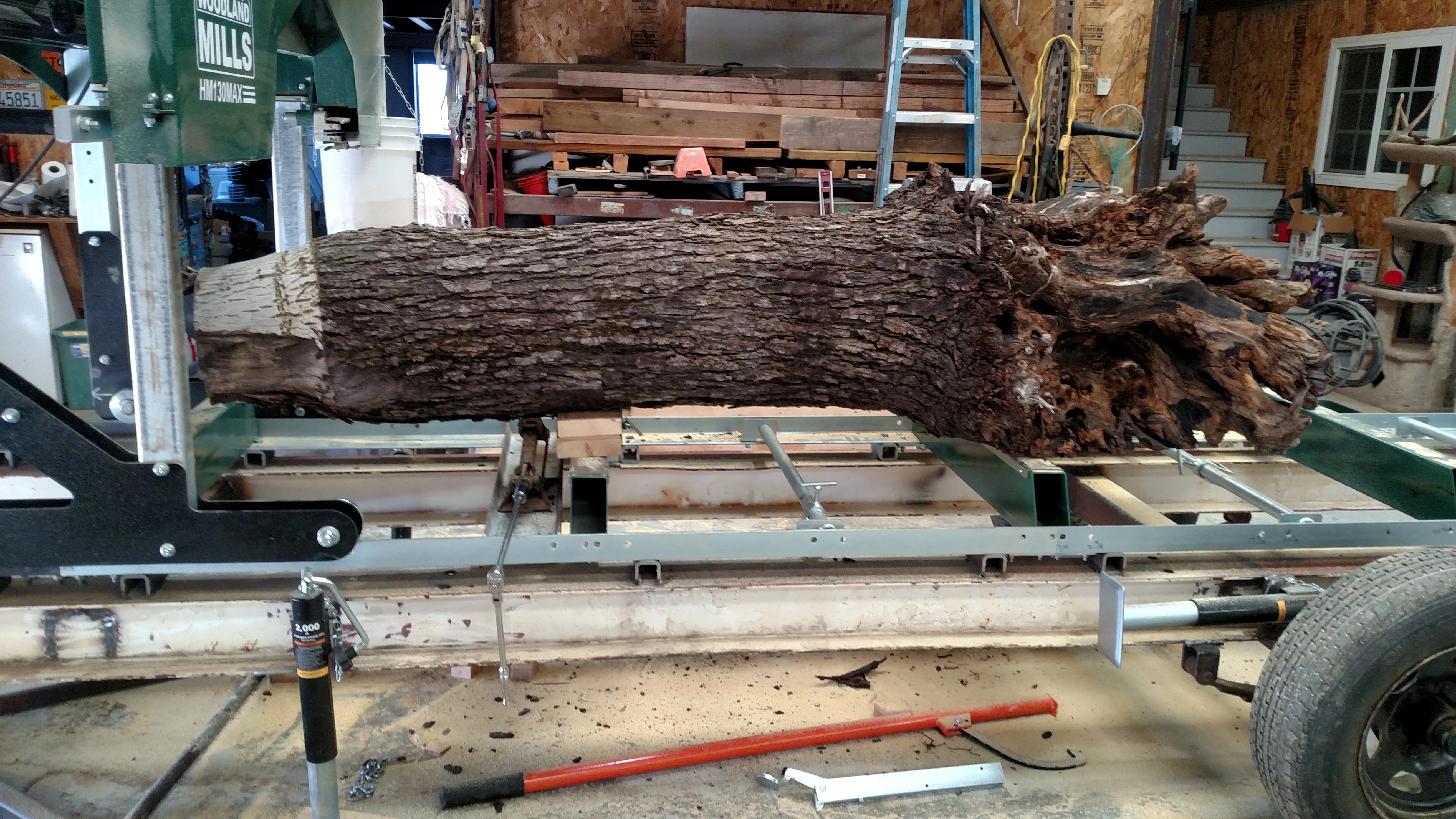

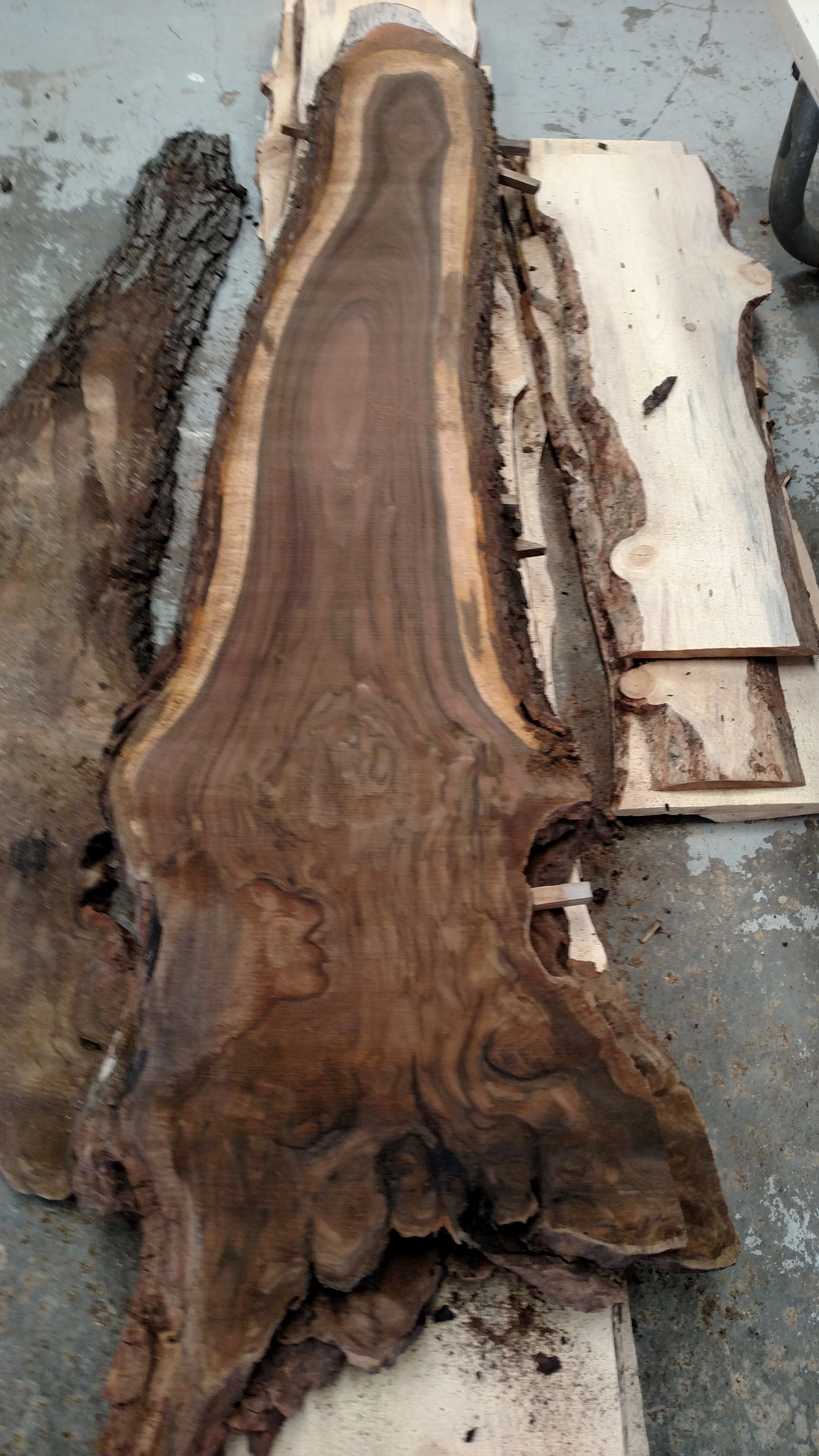

I bought a chainsaw mill to start with. Unless you want to spend a lot of time on first setup and are willing to accept very rough sawn lumber then a chainsaw mill will do fine. There's a lot of drawbacks to using one. Once you start to need accuracy in the cuts and being able to saw dead parallel to the grain, you will abandon the chain saw mill and get a bandsaw mill. I have a Woodland 130 Max. I built my own extended rails and a trailer for it. I can now mill 30" wide, down to 1/4" thick by just over 16' long. That's not happening with a chainsaw mill.
